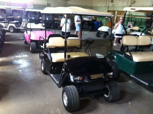

Here is my cart when i dropped it off- (I'll post new ones when i get her back)
