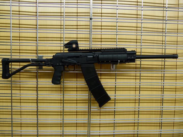

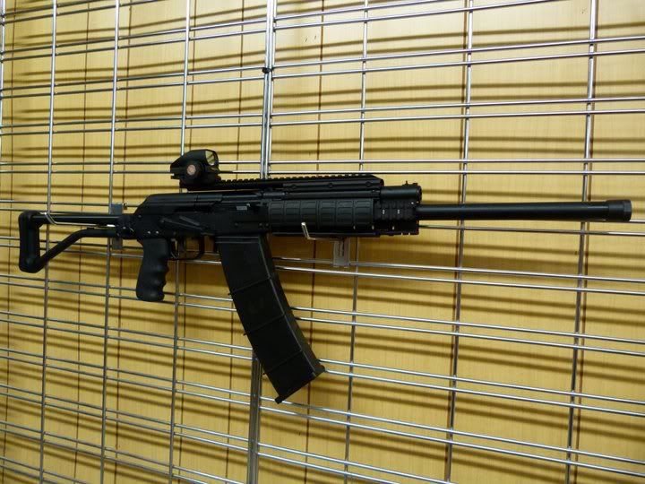

Heres an example of the Saiga conversions were doing at the shop. I'm not really the shotgun type, but they're fun to do and look cool as hell.

Do you leave the bolt hold open device intack or remove it??
I've seen a few of these before & with the factory style hammer/trigger & trigger guard moved forward they are much nicer than they are as they come..
Is that an Ace Folder Stock??

Midnight Raver, I put this one together for a customer. I've been trying to talk the boss into building one for the shop
Glock 17L, That is an ACE stock with the folding mechanism. I keep the bolt lock in but I modify it slightly so the spring on it will stay put. I also move the trigger group and grip forward utilizing a tromix fire control group,a new trigger guard and Houge grip. Of course I touched up the finish on the bottom also. The quadrail is a UTG and fits like a charm with no modification needed.

i did a saiga 12 conversion a few years back. i used my AK building tools to just slap rivets in the holes from the conversion and reused the old triggerguard with proper rivets as well. i like the look more then screws. i refinished it in molyresin flat black like most of my guns.
its changed a bit since the pics though. i got one of those MD arms adjustable gas plugs and a couple surefire 8rnd mags and a md arms drum.
