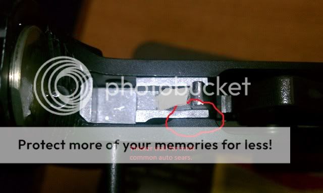

Ahhh Funny you guys mention the shelf...PSA as of Jan went to a high shelf. I bought one in Dec and it was a low shelf and had the bulging metal in the side wall which is a perfect fit for my auto sear. Too take this a step further not all were low shelf before Jan. It is really weird but the pictograms before jan were low shelf. The safe/fire marking lowers have always been high shelf. I couldnt be happier with my PSA. Now that I figured out the bolt bounce issue it eats anything I feed it. Just glad I bought when I did. I called PSA about a month ago after noticing that new lowers coming had the smooth walls all the way back and had the high shelf. I asked them why the change and they said they had lost their variance as of Jan. He said the ATF made a ruling in I think he said 2009 prohibiting low shelf lowers with the bulge in the sidewall from being made. He did say they were giving out variances to companies who were already making them but he said they lost the variance but he didnt want to explain. Its funny that most popular brands dont have the variance to make them. Bushmaster does, but Rock river doesn't. Too take it a step further I called the NFA Branch and asked them about the variance issue and they explained to me that some companies are getting away with it because they do one part but not the other. They will put a low shelf but they will not put the thicker sidewall or they will put the thicker sidewall but then a high shelf. As long as they dont do both they are legal. as Clicker knows this is why my spikes wouldnt work. The shelf was low but it didnt have the thicker sidewall so the sear was just bouncing in the lower from side to side.
If I ever wear out my PSA I plan on buying a bushmaster or LWRC since I know they will work. I just got real lucky with my PSA.
Pic to show bulge in sidewall and also low shelf.
