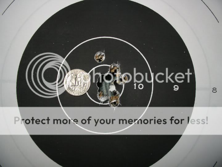

Here's my most successful cast load to date:
.357 mag
Lee 358-140-SWC pan lubed with NRA formula
8.5gr Accurate No. 5
WSP primer
Mixed brass
Runs 1010fps on average out of my 2.5 inch model 66. I can shoot them by the hundreds with no leading at all.
Here's a target from 10-ish yards as I was running a dozen of them across the chrono
