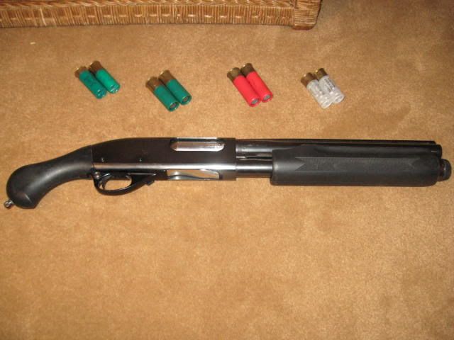

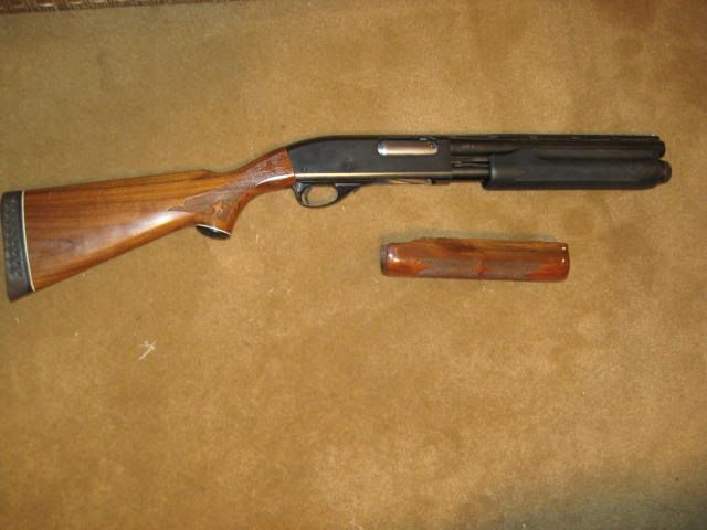

The overall length and the barrel length of an SBR or SBS is recorded on the Form 1 or Form 4, this is true. The inaccuracy is that the barrel must remain that length forever. You can swap upper receivers on an AR-15 SBR all day long and change the barrel from 4" to 7" to 11" to 14" to 16" to 20" etc. Same thing with a Remington 870 SBS. You can have it with a 12" or 14" barrel for "duty" but put an 18" or 28" barrel on it for hunting whenever you want.
This is my Remington 870 SBS:
This is also my Remington 870 SBS:
