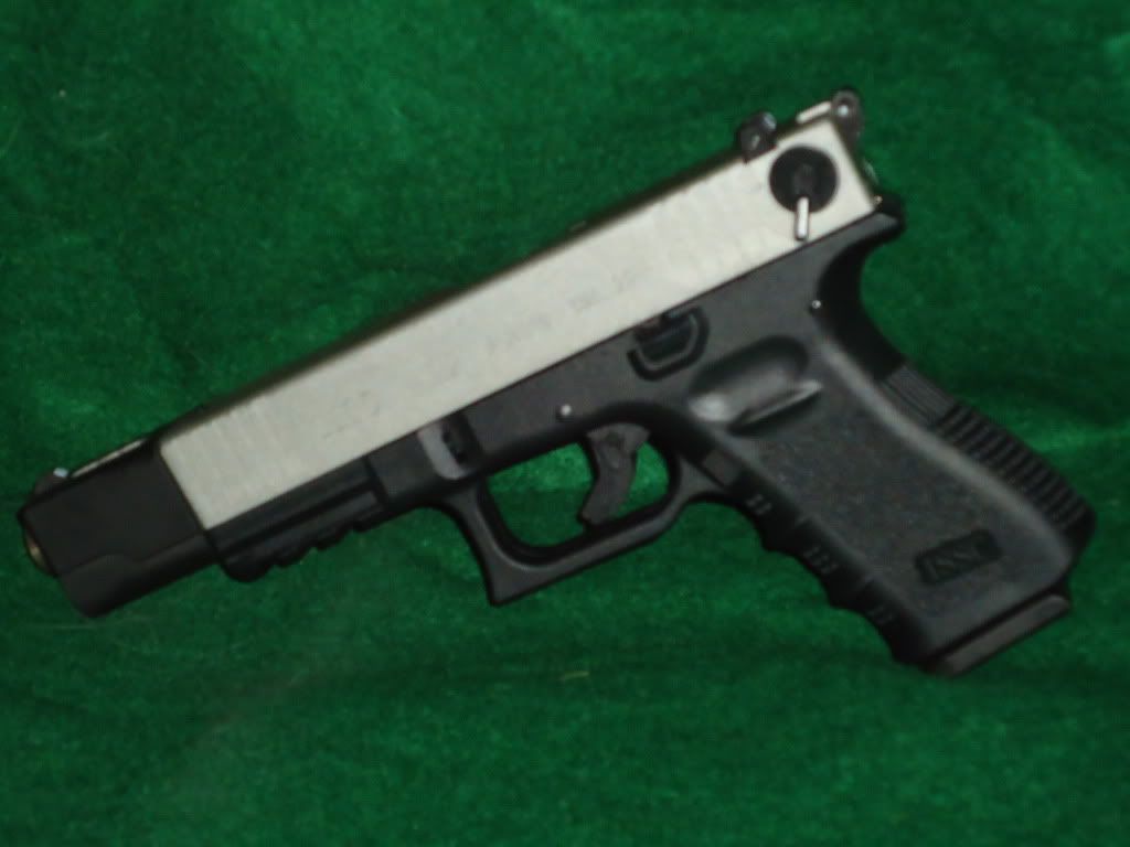

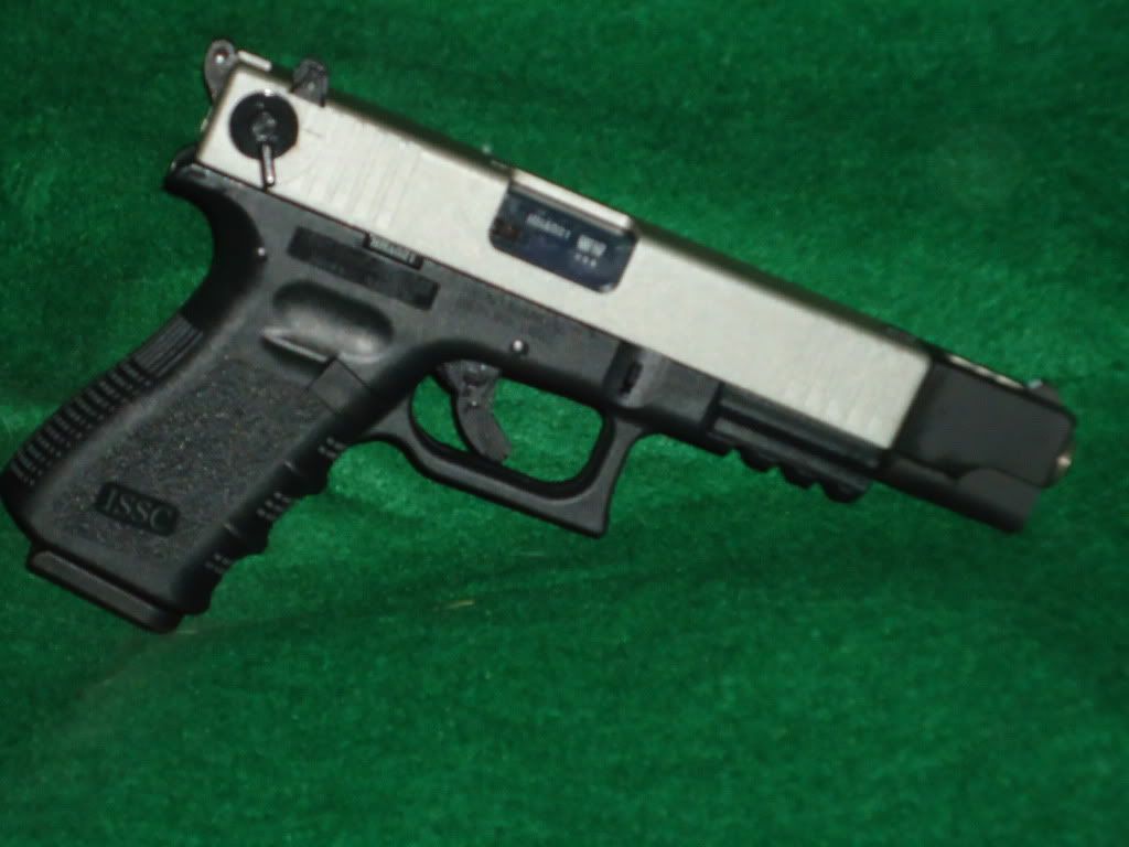

I picked up a new plinker from Bud's Gunshop. The transfer was handled by Beau at HHB Guns with his usual fast, friendly & professional service. the Pistol is the ISSC M22 Target pistol. It has a 5.5 inch ported barrel. It looks similar to a Glock. Not a bad practice gun for Glock conceal carry owners.

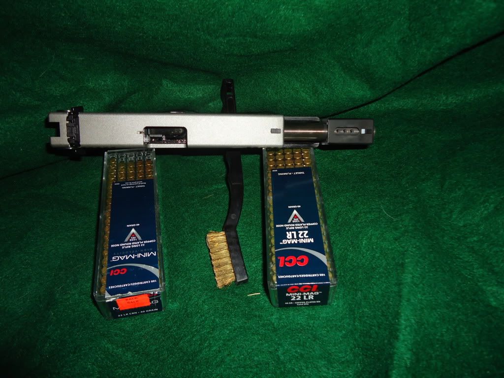

I ordered 800 rounds of CCI Mini Mags in preparation for breaking in the pistol as recommended by ISSC. Today I had a chance to try the pistol out in the side field. I cleaned the shipping lubricant/protectorant from the pistol and lightly lubricated the slide rails, barrel, recoil spring and hammer. I did not polish the feed ramp as others had done. My son-in-law and I fired 100 rounds of Mini Mags in groups of five or ten rounds. We fired slow and rapid fire. We had one stovepipe which may have been caused by my son-in-law's inexperience with pistols. We had no Failure to Fires as some had reported. The shellcases showed a solid firing pin imprint.

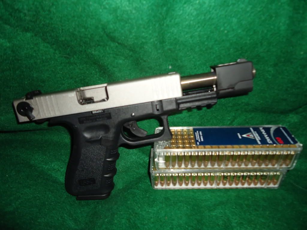

Took it out today and put another 100 rounds of CCI mini-mags through it without a hiccup. I did have one FTF. I pulled the bullet and there was no powder in the shell and no primer in the rim since I tried three different times to fire it before I pulled the bullet. I let my Brother -in-law try it out and he was very pleased with the pistol. So far, I haven't had any issues with this pistol and enjoy shooting it.
No threaded barrel. The compensator is held on with a set screw. I'm seeing fewer complaints about the 4" barreled guns. I haven't seen a complaint about the 5.5 threaded or the ported barrel since Dec. I have put 300 rounds of mini-mags through it and cleaned it this past weekend for the first time since starting the break-in process. It did not give me a moments trouble.
