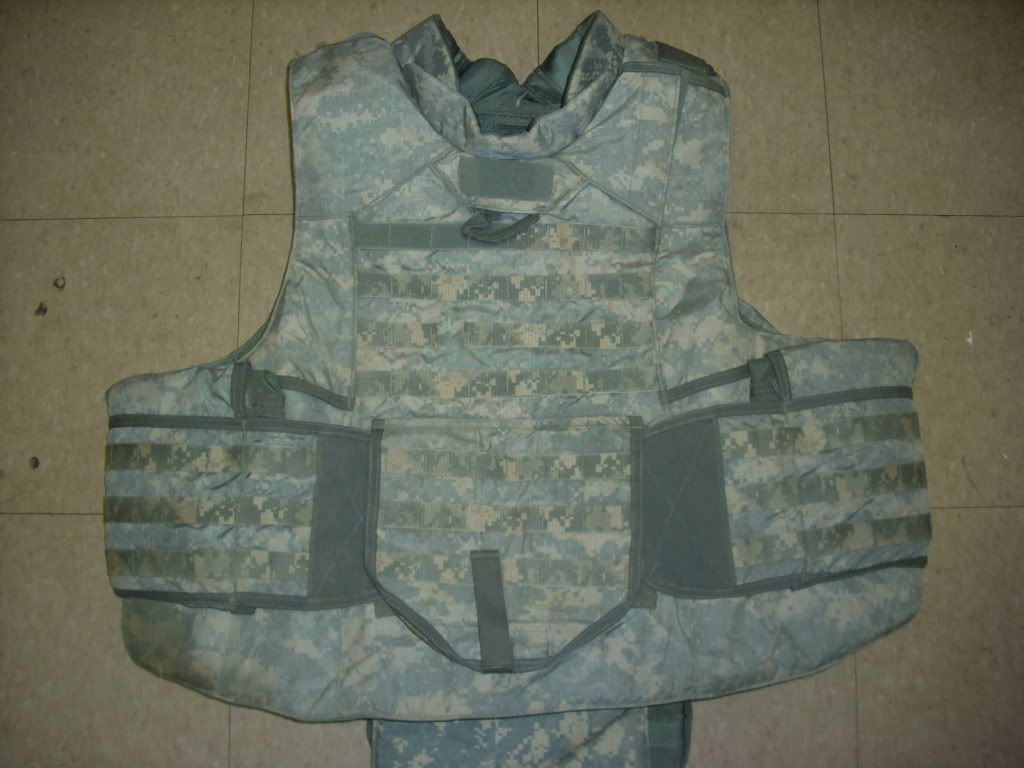

All the above is a preface to me showing off my armor, anyways.

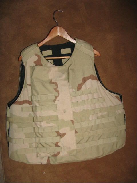

For my wife, she has a Desert Camo XL-IBA with two brand new XL-ESAPI plates. I added a few panels of extra, new Kevlar that I cannibalized from assorted up-armor parts kits like I explained above. The vest is XL but she isn't XL. This vest is loose on her but will have to fit the bill until I can acquire one in her size. I will eventually add two M-16 magazine pouches to the front and two 1-quart canteens to the rear. She is getting an SBR AR-15 in the coming months so this combination suits her needs for "last line home defense" should Hurricane Hugo's grandson show up and destroy civilization for another consecutive month or two.

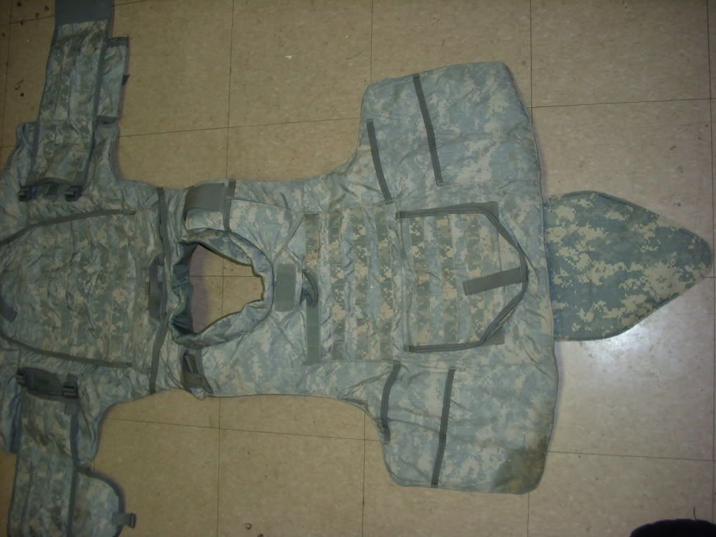

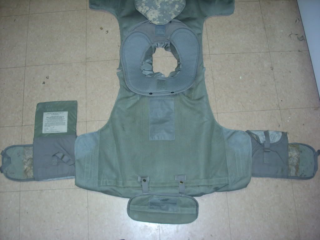

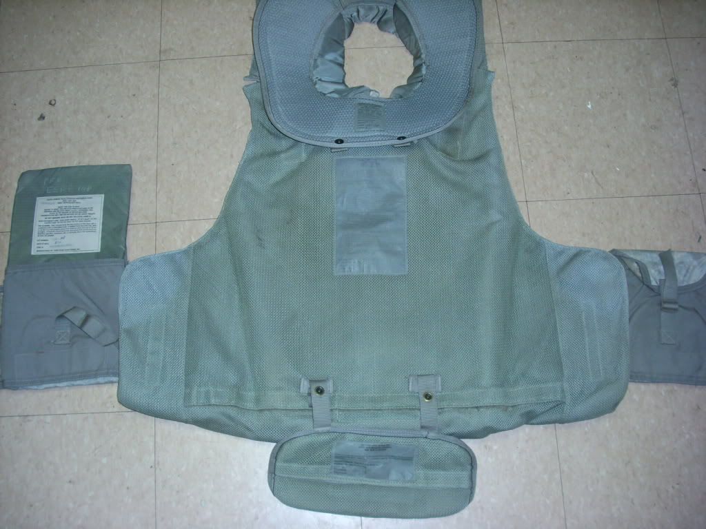

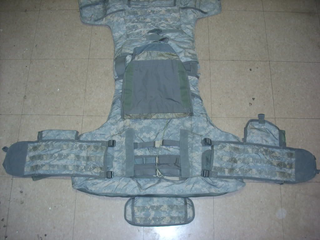

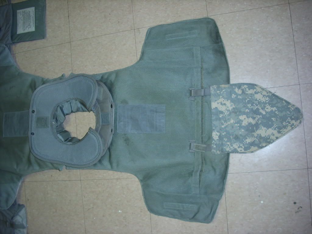

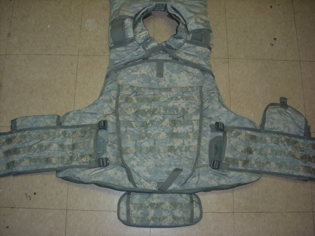

For myself, I have an ACU XXL-IOTV with both deltoid (upper arm) protectors, neck yoke protector, groin protector, ass protector, and both side protectors installed. I have full-torso-wrap Kevlar protection. For plates, I have front and rear brand new XL-ESAPI and two used MEDIUM-SAPI installed in the side protectors. I figured a little extra plate protection on the sides would be a good thing to have should I need to keep my house safe from land pirates during times of "extra-legal civil strife." The sonofabitch weighs 40+ lbs naked, without any magazines or water. I'm not having to ruckmarch anywhere and, instead, am going to be fighting a defensive battle from behind cover. Since I am not abandoning my family, I don't need maximum mobility. I need maximum ballistic protection. I feel I have it.
And, just in case you're wondering what a little lady looks like wearing body armor, here's my wife showing off my IOTV with all four plates installed. That smile of hers quickly turned into a grimace due to the weight. It made her appreciate her "light" IBA, though!
