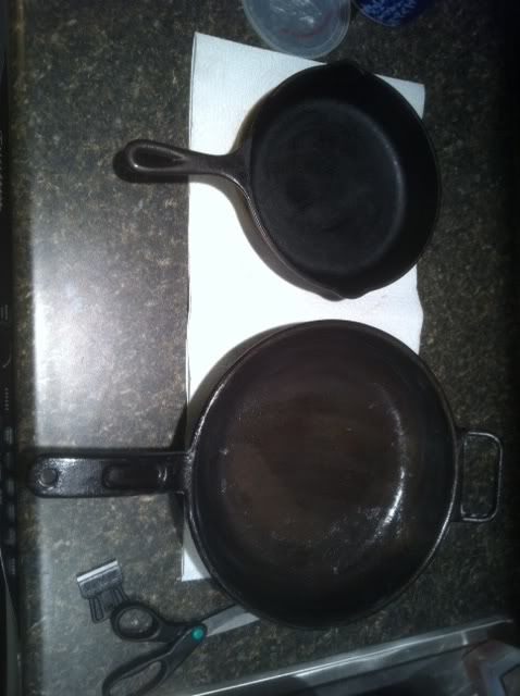

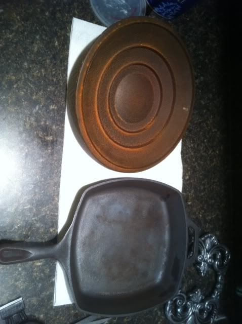

I got a hold of some old and some new cast iron, some in better shape than others, but all in disrepair. I spent this Sunday putting it all back into service. I used a wire wheel, steel wool, brushes, and a generous helping of elbow grease. In total I got 8 pieces done today. They will be ready to cook by tomorrow after they completely cool, although I will probably re-season them next weekend for good measure.
These pictures will show you kid of what i was working with. The pictures show (from top to bottom) -a raw piece, one that has been grinded and is ready to go to the steel wool, the first one to come out of the oven, and one that is in grease and ready to go into the oven If anyone is interested I can share some info on how to properly restore and season Cast Iron- At least my version, everyone has their own.
