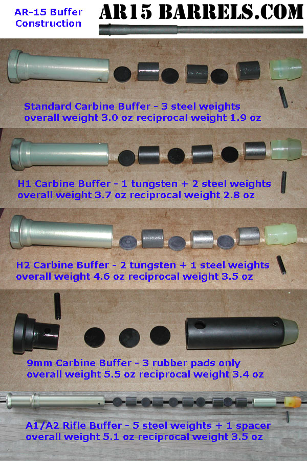

What is the difference in a standard buffer and their H, H2, and H3 buffers???
Just guessing...I would say 16" 18" and 20" barrel buffers....
Or maybe pistol, carbine, and rifle...
The standard buffer is for full sized A2 stocks. The H, H2 & H3 buffer are shorter for use in CAR stocks - don't run them in a full size stock. (ask me how I know)
The difference between the CAR buffers is weight with the H3 being the heaviest.
I thought those were designation for the weight of the buffer.
This was a huge deal with my M16. I had the M4 stock and I tried all of the Buffers H-XH and NONE of them worked. I ended up giving up with the M4 stock and went with a full size Rock River operator stock because the only buffer I could get to run was the A2 buffer..Besides having full auto the only other reason you would need a different size buffer is if you are shooting SBR's or Suppressed weapons. Shoot both SBR and Suppressed in Full auto and it really gets tricky getting the right buffer. Too much weight it will short cycle not enough weight you get what I had BOLT BOUNCE...
You're correct. I should have stated the standard A2 buffer is for full size stocks since there is also a standard CAR buffer.
