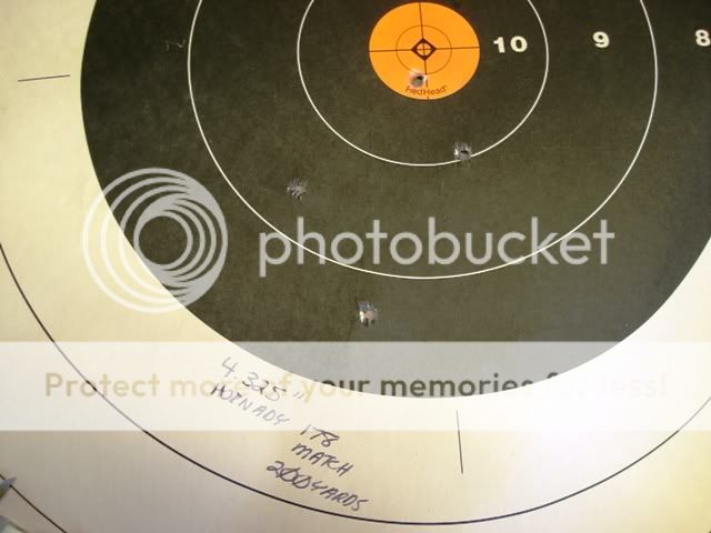

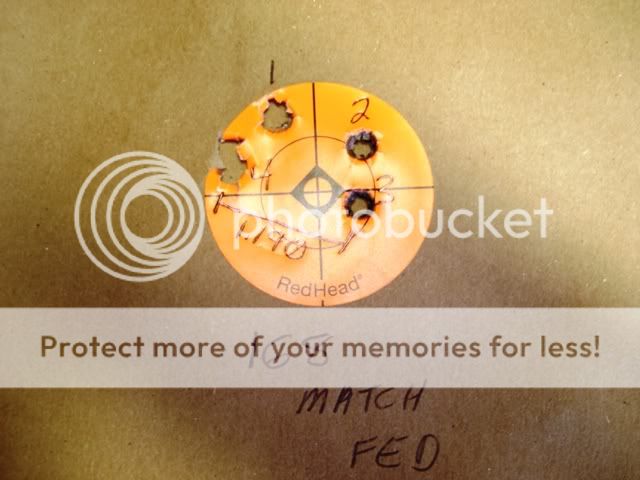

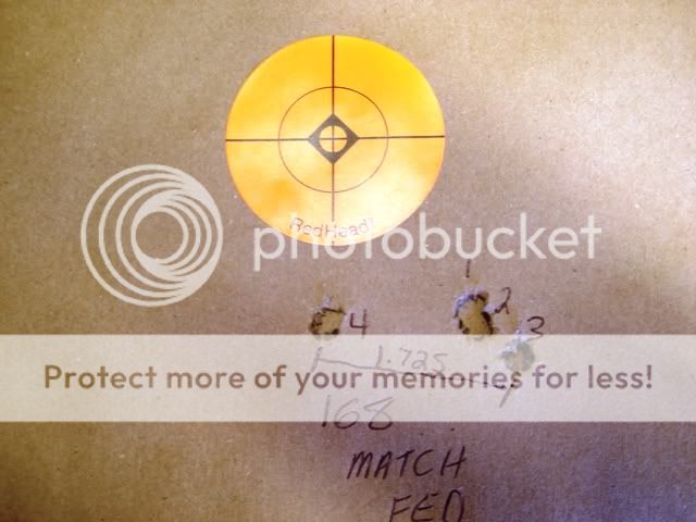

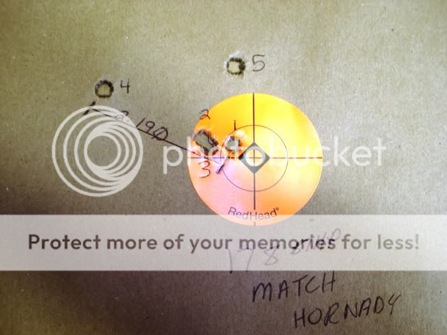

I made it out to the range today. Wonderful 75 degrees with a light breeze. As I said before. The gunsmith ran about 20 rounds throught the new barrel so I finished the break-in today cleaning every three rounds with Hoppes #9 and sweets 7.62 copper solvent.
I had a box of federal 168 SMK's that I shot at 100yards and then I shot some Hornady 178 BTHP Match and then four rounds of 7.62 Military match Lake city M852's at 100 and 200 yards. The 852's shot better than the Hornadys.
Everything was shot off of a Caldwell lead sled.
Needless to say I am very disappointed in my Gun as I now have about $1700 invested and the best group of the day was 1.190" at 100 yards. My buddy was sitting right next to me with a stock rem 700 from Dicks with $460 invested he was shooting 7/8" groups with fricking core-locks.
I hope I can do better with handloads or this thing is going on Gunbroker soon.
Pic#1 was Fed 168 at 100 yds.
Pic #2 was Fed 168 at 100 yds
Pic #3 was Hornady 178 Match at 100 yds.
Pic #4 was 7.62 Military Match M852's at 200 yds
Pic #5 was Hornady 178 Match at 200 yds
So whats your thoughts???

if you handload try 168 gr amax with 40 grains of varget it is working real well in my rem. 700 LTR
Don't give up on it yet, give it a good break in period first. Put some more through it and then work on some handloads. It wasn't all that bad for your first shots with a brand new system.
I'm sure you're going to get it tweaked in nicely. ;)
I spoke to the gunsmith tonight while I was trick or treating with my kids and he told me my satisfaction is what he wants so he told me to reload some rounds over the next few weeks and see if I can hone in a good shooting round. He said if it doesn't work out bring it back and he would build me one from scratch if need be to make sure I'm happy. Atleast he is willing to work with me.

I agree that handloads will improve the result.
I gave my rifle to a good customer who has been reloading for 40+ years. He has forgotten more than I know so I figured I would let him test all the powders before I took it back to the gunsmith. He tried some different loads including H4895, IMR 4064, Varget, Reloader 15, and Accurate 2520......He told me that he had good results with all powders except the reloader 15. He said he couldnt get that one to stay on the paper. Accurate 2520 won the challange today with a five shot group covering with a dime. He said if it came down to a close second it would be H4895. He said he doesnt think there is anything wrong with my rifle. Just needed some good handloads.
