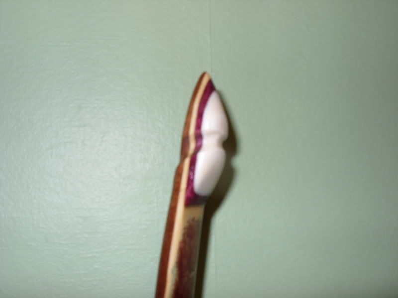

Well on the Hello thread there was some people interested in my work. I am creating a website in the future but for now here are some of my bows that i have done in the past...i have tons of other pictures but this is what i have in PB right now. My work ranges to simple hickory board bows at 125$ or linen backed kids bows for 75$ and up to bamboo backed reflex/deflex bows for 350$
hickory and bamboo
IPE and bamboo
Hickory stave bow cut from a log....old school

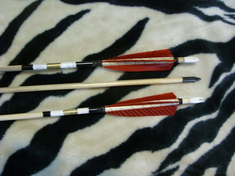

Making them is an even more talented skill, good work Sir! I know from personal experience even gluing the heads on those arrows can be a royal pain. I've done somewhat ok with my field points over the years, had to redo some over each time though. Broadheads are a totally different ball game, I haven't even attempted that yet. Got any tips(no pun intended) to successfully accomplish this task?
Bow_breaker
May 16, 2010
61
I haven't payed for the site as of yet. Since my dealership closed down and tossed me out the door i may start my hand at it full time.
As for gluing on broad heads i find that using good epoxy helps.
Take an oversize pencil sharpener and cut your shaft true.
Dry fit your broadhead to ensure that it will fit corectly when dry without any preasure on any side, sandpaper slightly to get it streight.
Then clamp it 90 degree to the ground point up in a small vise.
Take a thin piece of cardboard (i use cards from an old poker deck) and cut small hols in them slightly smaller than your shaft diameter, slide them over the shaft to the location of where the broad head, this stops the glue from running down the shaft.
Mix your epoxy and set the head in place,check alignment and wait till cured.

2 companies that i have used are http://www.hildebrandarrowshafts.com/products.htm
There sitka spruce shafts are nice.
I have recently bin using http://www.hildebrandarrowshafts.com/products.htm The arrows that you see in the pic are them...they are a little bit hard to straighten but once they are clear coated and set in shape they hold up nice...also spine is more consistent.
Or you can go with the free and primitive option of looking around creeks for river cane. I also have a shaft turning jig and make poplar shafts but they don't spine out to consistent.
If you go modern fiberglass you can gently cut off the plastic crap feathers and glue on real ones...its what i hunt with. :oops:

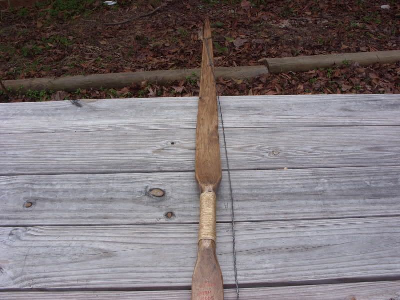

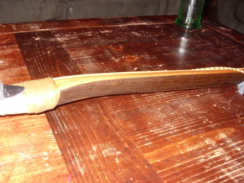

Most of the bows that I make are laminated reflex/deflex bows with a strip of either hickory or bamboo (natures fiberglass) to hold the shape and tension to the back. But every now and then I get in the mood to just pick up a stave split out of a log and whittle one up the old fashioned way.
This is a 60 inch long hickory stave bow. It pulls [email protected] The string is b-50 Dacron. Finish is true oil. The shredded stripes on the back are cambium bark left on for looks.
No modern tools touched this wood except for the chainsaw that my Ponca freind used to harvest the tree.
