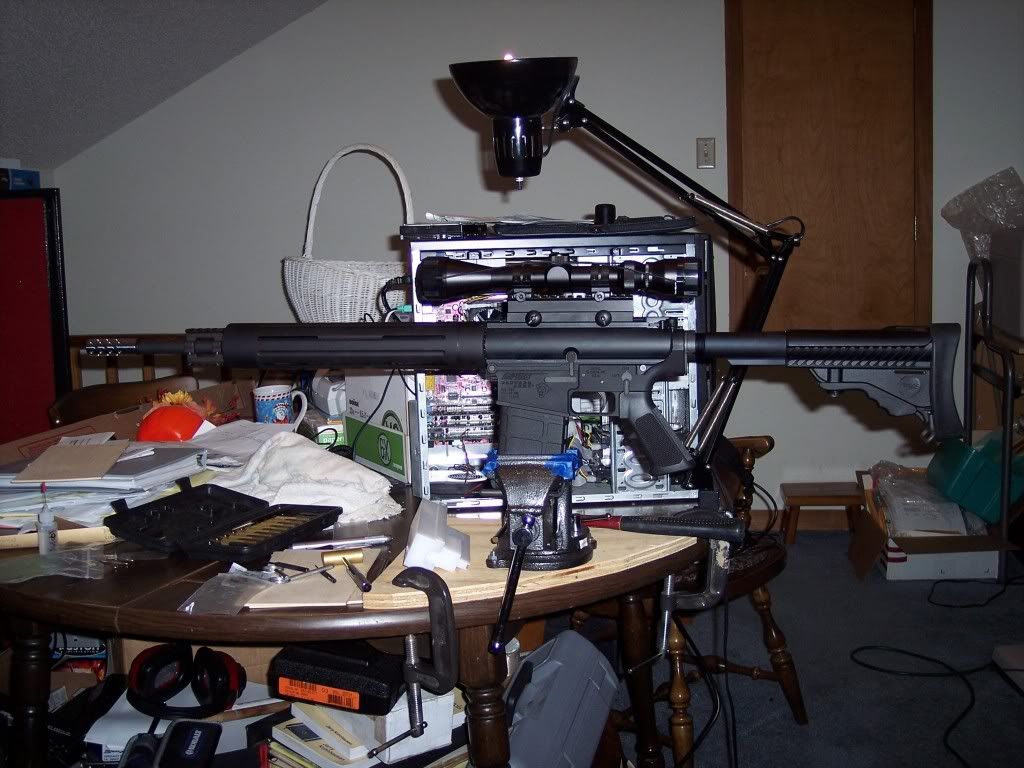

AR 308
It isn't fancy but I hope it shoots straight.
I bet they thing would just be getting warmed up at 600 Yards. I cant see it real well but I'm thinking the optics will be the only thing to stop us from shooting 600. You prob wont have enough come ups without a scope with tactical/target turrets (14.5-16MOA for .308 at 600) But we can sure as hell try :cool:

That is at best a 200-300 yd scope and inexpensive (cheap) and old , as well. But I would give it a try. I'm saving up for better glass for the 20" AR15 and this one. Some day my ship will come in if it doesn't sink first.

The 329.00 would be the top of my budget right now. I can't justify more for casual long range shooting. I read the comments on sniper hide and that scope would do what I needed. How did they shoot with the old leatherwood scopes and hit? I know it is more than the equipment. There is a lot of skill and knowledge that the scope can't make up for. I hope this rifle will let me reach on out there.

I took it out to Boggyhead today and I am in love with that firearm. The brake and the AR platform gave me the softest shooting rifle of that caliber I have ever had the pleasure of shooting. I got quite a few complements on the rifle and several people mentioned reading about the trip to East Coast to get it ready for me.
Thanks again for the great work.
Henry
I'll say it again, It is the man that pulls the trigger, not the equipment, that is most important. That said, I'm going to get the best equipment I can afford to help me do my best. I'm thinking about building a .243 upper for that AR308 lower. I think that would be fun.

I don't expect to be able to get the velocity you have although with the Polygonal rifling I'm suppose to get an appreciable increase with all other factors being the same. Suppose to be less drag on the bullet in the barrel. Also less deformation from lands and grooves. I hope that is true. I built this to be a compact (18" barrel) service level weapon for the Zombie Apocalypse :D An increased long range capability would a pleasant bonus.
Dale,
I'll be back in. I want to get some factory loads to try in it The Fed. white box NATO rounds worked OK yesterday and the Fed Amer. Eagles did well. I've got some antique Winchester Power Points in 150gr I hunted with as a teenager I'm going to try. I'm still breaking it in so it will settle in after another 40 or so rounds. I very happy the way it is shooting right now. It can only get better. Now if only I can. :roll:
