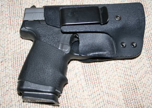

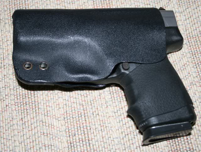

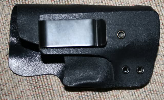

That's where I buy my Kydex, knifekits.com You don't need a vacuum box to make holsters just the foam pads to to put pressure on it to form around the firearm. It only takes me about 20 minutes to make one. Here's my IWB tuckable holster I make.

Redhat - that is a nice looking holster that you made. I like the riveted belt clip better that the formed Kydex belt loop. How much Kydex did you use to make it?
You just need enough Kydex to fold over the firearm once it's pliable so the amount is determined by the size of the firearm.
